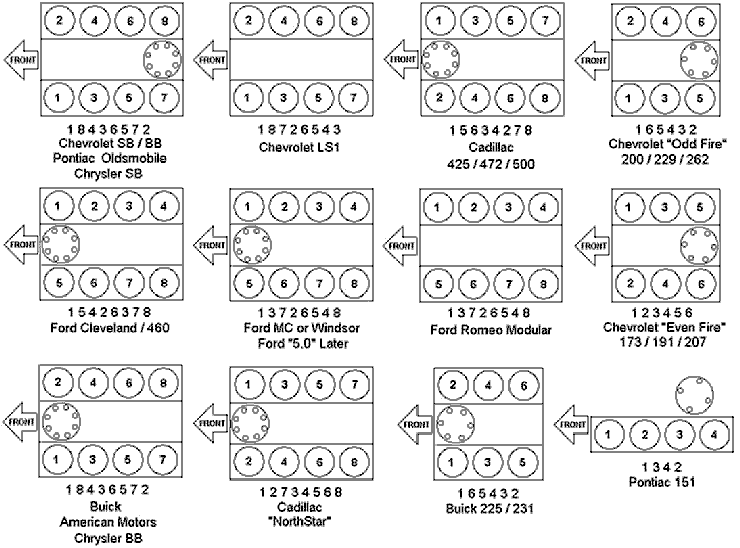

what order do the plug wires go on the distributer

What you probably need is the firing order by cylinder.
