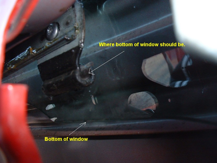

someone attempted to break into my car last night. (see pic) and they broke the window in the process. however when the window broke, the alarm scared them off. and because of the window tinting, the window didn't shatter. which was good cause the cops were able to get prints.
but now to my question. the guy came out today to install a new window. and said that i am missing a piece that goes on the side of the window (front of the window towards the front of the car) that rivets to the window (like the lower pieces) and helps guide the window up a side rail or something.. i know there are two peices that are on the bottom of the window. but is there one on the front side of the window? the window does have quite a bit of movement but i also don't have the black rubber piece that guides the window up at the front of the door. should i continue searching the the bag of broken glass for this peice or should i just tell him tomorrow that it doesn't exsist?

well an update on the window and the police. we called today and they said it will take a few more days to run the prints they got. but the good news is that an investigator (sp?) is gonna get a hold of us.. and a friend in my car club said he might know who did it, some people that live near him and me that do alot of this kinda stuff. and just a few other things. so hopefuly they will catch these guys...
but the window guy came yesturday to replace the window. took him like 3 hours and he barley just got the window in, and i had pulled the door panel for him already!! and he still didn't get it installed correctly.. only one of the mounts on the bottom is actualy attached to the window!!! no wonder why there was alot of slop in the window. but i guess i cant' blame him cause it was dark last night. but if he doesn't hurry and get here today then its gonna be dark again!!!! ill have to set up the 500watt flood lights for him..!
