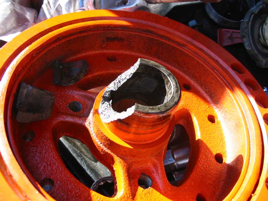

Heres what happened to my balancer. Im still not exactly sure what caused it, but I think it was when I installed the balancer. I think when I was tapping it back with a hammer, the key came out of the crank a bit which caused a hairline crack in the balancer. Then I believe it was only a matter of time before the crack turned into this. For a week I thought I had a misfire, not a knock. If the balancer is turned, it feels almost exactly like a miss, at least on my engine. It may not be so noticeable on a 305/350 since they are internally balanced, and the balancer is not heavier on any side.
