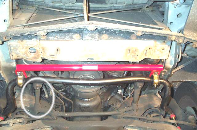

I just had a nother look and noticed that this idler arm has a lot of play.. could this cause a snap sound?

Well I am positive now.. the noise is coming from the right of the steering box.. not the box, and not the idler arm.. though the play in that will probably be looked at after I solve this noise.
Odds are it's probably the fracture.. I'm gonna see if I can find it.
UPDATE:
- No Facture found. (This is a good thing)..
- Did discover the upper mounting bolt was loose
Tightened this bolt, and the noise was gone..
- Will hunt down a "Wonder bar"..
