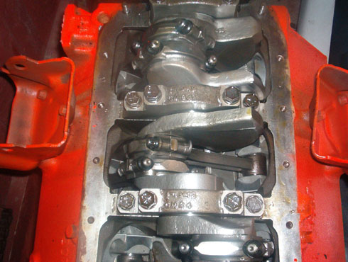

I am inclined to say that it is impossible for the crank to move that much, if you look how the crank and main bearings are made there is no way it can move that much, it would have to be eating up the counterweights on the crank and literally making all kinds of noise. look at the pic and you can see what Im talking about. I think they fubared the tranny and are trying to cover theyre asses so they don't have to fix it right.

Well, about the only way they could connect the trans problem to the supposed crank problem is through the front pump. That is why the idiot owner said if it was the front pump, they would not fix it. If the front pump was assembled, and for/aft clearances were not checked, that could cause something to let go in the pump. Everyone is right. It is impossible for the crank to move enough to damage a good trans, and the engine still run well. The CW on the crank would hit like 86redbird said. If that owner actually believes there is that much movement, ask him how the counterweights are not hitting the main saddles, or why the rods are even moving. With that much play, I don't think you would find a starter strong enough to keep cranking it over. Man, people like him really aggrevate me. and the fact he is a shop owner makes him even worse.
