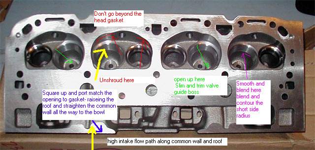

porting world heads
has anybody ported the world s/r torquer heads? where should i port at and what shouldnt i bother with?

Engine: 406Ci Vortec SBC

http://search.barnesandnoble.com/boo...79385472&itm=4
Best book I've seen for the DIYer.
