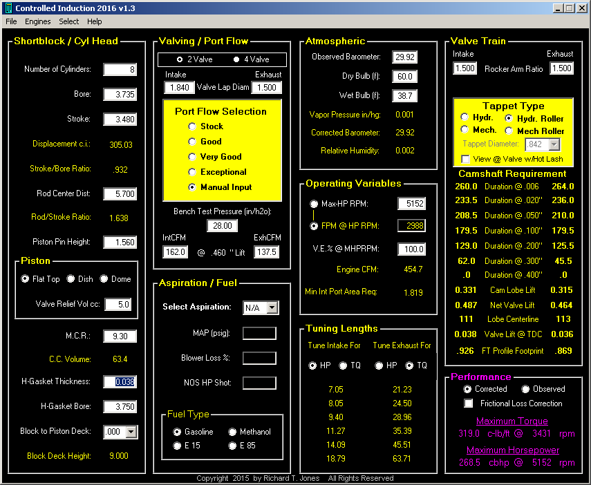

This would be one of those perfect examples to run through my software. If you have port flows for the heads and the rest of the normal engine parameters. I'll run your numbers and post the results. message me or post them.
Rick I can get those numbers for you.
I really like the Elgin 210/215 @ .050 roller can in a stock internal L03. It is 210/215 @ .050, .462/.470" lift, 110° LSA on a 106° ICL.

Post the bore, stroke, rod length, compression, valve diameters, port flows at .400" and .500" lift, bench pressure (in/h2o), rocker ratios, hydr or mech cam, lash if mech, and the RPM you want maximum horsepower to occur (Max-HP RPM).
3.735 bore
3.48 stroke
5.7" rod
9.3:1 c/r
1.84" intake
1.5" exhaust
28 in/h20
Intake @ .400" 158 cfm
Intake @ .500" 165 cfm
Exhaust @ .400" 133 cfm
Exhaust @ .500" 140 cfm
1.5:1 rocker ratio
Hydraulic Roller cam (Zero lash)
Stock drivetrain and short block would want the peak power between 4,500 and 5,000 rpm with shift points about 10% over
Edit- I have always felt people use the wrong cam with these heads and then wonder why they don't run well with a huge intake/exhaust duration, massive duration and lift split on a wider LSA. I feel these heads run best with a mild duration/lift bump, nearly square pattern grind, tighter LSAs and advanced valve timing. In a carbureted 10.4:1 350 application I actually ran a 282/282 @ .004, 224/224 @ .050, .480/.480" lift, 106* LSA, 102* ICL cam and it was a torque making monster.

Originally Posted by Fast355
3.735 bore
3.48 stroke
5.7" rod
9.3:1 c/r
1.84" intake
1.5" exhaust
28 in/h20
1.5:1 rocker ratio
That is enough information to determine the cam. Good thing you didn't want to turn it with those ports.

I took a little liberty with the RPM
