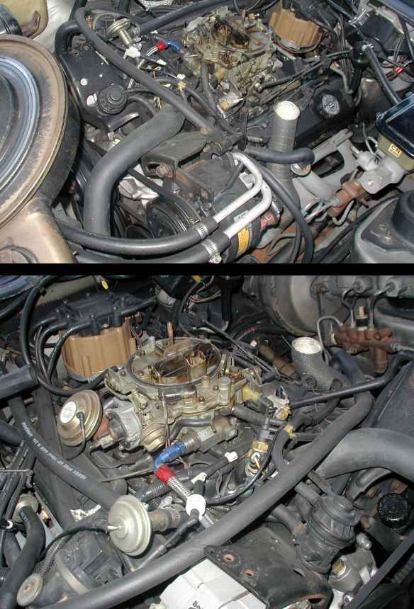

I mean EGR, AIR, EFE, all sensors and valves, basically every single emissions-related part. The entire stock carb and computer and all the stuff that goes with it is on there and operating.
How stock can something possibly look?
But that should give you a good idea of what does and doesn't cost HP... the stock carb and intake, for instance, aren't a restriction.

Ya see i don't have to worry about emissions in Alberta so a lot of what you have there wont be on my motor.
