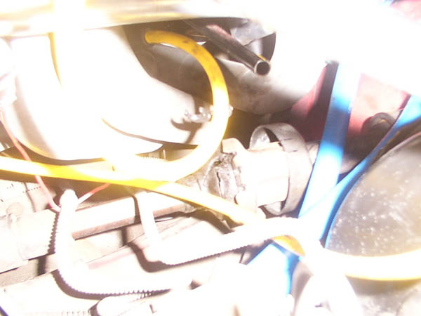

I was changing my spark plugs today and noticed this, I am pretty sure it wasent this way a few days ago because I diddent notice it when I was putting the manifold on. Im thinking it could have torn last night when I was giving it a moderate amount of gas
But what is this? Is this whole column the steering column? As you can see in the pic the rubber peice is torn and I can see inside . Is it safe to drive like this? Or should I fix it first?

heres a smaller lighter pic

hey, no that's not safe to drive that looks like it can go at anytime and you wont have any steering, get another shaft from the boneyard, 2 bolts and it's out it might be difficult with the headers though
oh yeah, thats the collapsable joint, in an accident it collapses so it doesnt push it through your chest

Anyone have a part number or the name of the peice I need.

Originally posted by 86Z oh yeah, thats the collapsable joint, in an accident it collapses so it doesnt push it through your chest
^^^ how about this?

it's discontinued, try a boneyard
now that i look at it closer, is it rubber? then it's just the seal, i thought it was the metal cracked, cheap replacement either way

SO even though its jsut a seal I could still lose steering?

if it's just a seal it will work until it gets enough crap in there to make it fail. i would try to fix it if necessary
