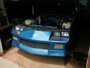

Well, I got it started. But it will not stay on. My guess is that the timing is off, or the carb needs adjusting, or (the big one) my stock electric fuel pump is not working right.
So, far the eng will crank and stay fired for about 30 secs. When I try to give it gas, it will "choke" or delay and the eng wants to die out when I get it close to 3000rpm. And sometimes when I'm cranking, a puff of smoke comes from carb. I checked the timing and it is somewhere between 0 to 4 degrees forward. Is this going in the right direction and where should it be set at? Someone said start off with 12 degrees forward.
I'm not gonna mess with the carb until the timing is right.
when I turn the key to the on position(with eng not started) I can see and hear the fuel going in the carb(initial fuel delivery by electric pump) without me pushing on the throttle. But I dont think that the electric pump doesn't know when to turn back on cause the ECM is not controlling the eng anymore. Am I wrong about this or is the thing really working right like its suppose to even without the ECM?
