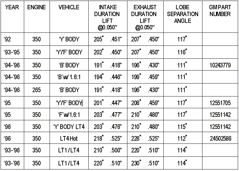

Here's a chart that Vader posts here quite a lot. I must say though that the cam I have (LT1 cam) isn't on this list.
The only way to tell for sure what you have is to break out with the dial caliper and/or a dial indicator as well as a degree wheel.
BTW, I spec'd mine. It's out of a '96 also. It reads as follows...
LSA - 116
Int - .450"
Exh - .459"
Int dur @ .050" - 203*
Exh dur @ .050" - 208*
As you see it has more lift than yours, but not quite as much duration, which is atypical of a roller cam.
