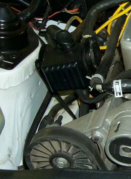

This black box in the center is the diverter valve.
edit: Actually, I'm wondering if you broke the nipple off of the top of the heater control valve? If so, just try to glue it back on. You can buy a new one at any auto parts store, it's probably not worth replacing if you could just fix it, though.
