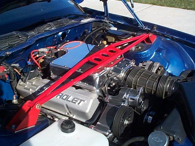

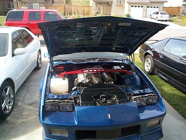

To all interested... yes, I am running a Hotchkis bar with my super ram , no clearance issues with some spacers I made. As you can see in the close up shots, I could probably even remove the spacers, but it works well now, so no need to try other things.....
Here you are.

This is the spacer... I made one for each side out of aluminum. You can see that the adjustment on the mounting brackets would most likely allow me to remove the spacers.

Oh, the hood closes just fine...

Very Nice car RU-QUICK.... Are those 255 or 245 tires on your car?
I have an Edelbrock on mine, it clears just fine. The brackets for the tower to tower brace are slotted. I just had to move it up and down. Until it fit under the hood without touching the plenum under load.

Thanks Mike.. The rear tires are 255/50/16 Drag Radials, the front are 245/50/16 Bridgstones...

I removed the hood insulation only because it was starting to look like crap, not because of any clearance issues. I forgot to mention that I am running the factory engine mounts.

DOC. the underside of the hood is the same on both styles.... Look closely to the stamping. A factory hood will work, IROC or RS.

do you have any problems with the engine torquing under load and hitting the brace? I know my engine moves a good 1/3" with the stock mounts when the engine is revved. It doesn't look like you have much room under there

No, intake does not touch the bar in any spot. I have checked it with clay actually, just for the simple fact that I figure the shock from hitting would eventually hurt something, so I made sure it was 100%.
