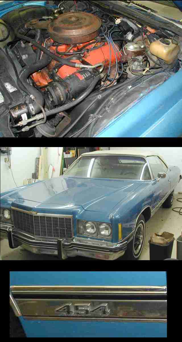

Some 454s came with no electronics whatsoever. Some came with regular carbs & HEI. Some came with electronic fuel injection. Kind of like the 350. But AFAIK, none of them has ever come with direct port injection, from the factory. But that has nothing to do with whether it can be done or not, or whether it's "compatible" with electronic control or not.
Yes, I'm rather familiar with them.
