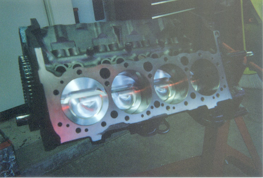

Here is a pic of the valve relief. Let me know what ya think.

Ominous- my setup was a 383 stroker and used heads with 2.02/1.60 valves and a much less aggressive cam than yours. I had MILES of valve-piston clearance.
Just remember that clearance problems happen during OVERLAP between the exhaust and intake strokes when both valves are slightly open, not at max valve lift (when the piston is half way down the bore).
Always best to check with some clay and mocking up the assembly temporarily, but I'd be REAL surprised if you have clearance problems.
