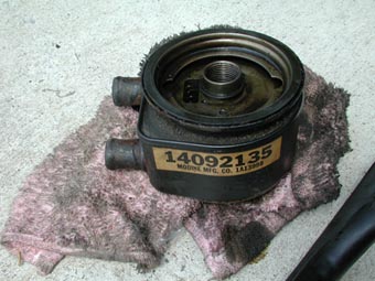

if you changed your own oil, the damn oil cooler cannot be missed. if you saw the bypass adapter (an aluminum thing that the filter screws onto) you don't have a cooler. the cooler is all metal where the filter screws onto and flat. it has two short pieces of rubber (about 4" in length) connecting it to the (5/8" or 3/4"?) metal hoses. these metal lines are black in color or rust colored :sillylol:. you can't miss it. i hope u have one. best of luck.
on another note, just cause it's an IROC doesn't mean it will have the KC1 cooler. my l98 89' IROC did not have it . my l98 88' IROC did though.

From: Surrey, BC
Originally posted by 89IRO
But even though I don't have the KC1 option, I do have the L98, so do are you guys sure I have the oil cooler?
The reason you dont have KC1 is because it isn't a RPO code
The RPO for the oil cooler is KC4.
Old Jun 24, 2003 | 10:05 AM
mystikkal_69's Avatar
Posts: 1,823
From: San Antonio, TX
Car: 1988 IROC-Z
Engine: L98 (350 TPI)
Transmission: MD8 (700 R4) + 3.42 LS1 Rear
good call iroc22. it is the kc4 option.
here's what it would look like right above the oil filter....

OMG, a picture!! Praise the Lord! I knew somebody would manage. Thank you. -89IRO
