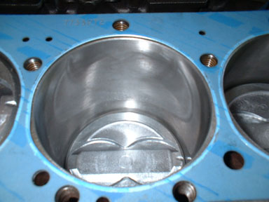

Attached Thumbnails Compression Ratio (post-rebuild)?-post-rebuild-piston.jpg
Old Jun 23, 2003 | 08:19 AM
boogie's Avatar
Posts: 266
From: Coushatta LA
That looks like a typical 10cc dish rebuilder piston, your CR with a standard bore,.041 compressed thickness head gasket and 64cc heads should be in the 8.9-9.0:1 range.

Standard bore is 4.00, your bore is 4.030. the power loss would be slight. That looks like a felpro rebuilder head gasket, you could go to a thinner gasket such as Victors nitroseal .026 compressed thickness from NAPA and gain back your CR. Part # is 5746
