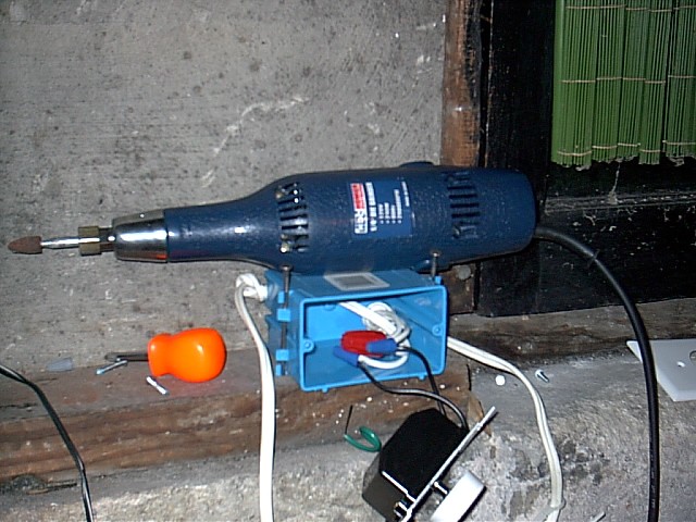

I attatched a pic of what my die grinder looks like. This pic is not mine but the same thing. It has a fairly small nose so I might be ok.

That grinder looks familiar.

Well, just a word of caution. I don't know what the RPM of your grinder is but mine is around 20,000. If you use them 6" cutters you had better slow down your grinder RPM or the viberation can get out of hand. I have a reostat for mine and can dial down the rpm. Works great!!

I already wired up a dimmer switch for it.
