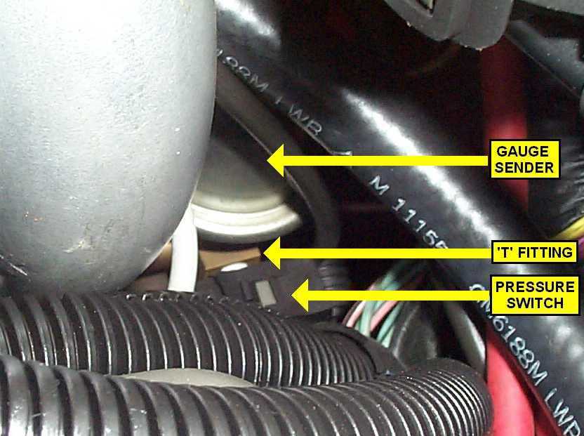

The problem seems to be coming from either the orange or the red wire from the fuel pump relay. One of the two is grounding on somehting causing me to keep blowing fuses. How feasable would it be to cut those two dead and simply run new wires?
Old Sep 1, 2003 | 07:59 AM
Vader's Avatar
Posts: 19,668
Likes: 314
Eye,
I'm not certain on your '89, but an '86 has the pressure switch right next to the distributor. There is a "T" fitting that plumbs it to the oil pressure transducer for the dash gauge. Newer cars have a switch on the left side of the block, down near the oil filter. Yours could be either place, but if the fuse is blowing immediately, that could be at fault. Take it out of the circuit to see. You should be able to simply unplug it.

Dirtrocker - Thank you for the help, but I do have a TPI motor.
Vadar - I appreciate the pic, it;s so much easier to have a pic when dealing with stuff like this. I'll check it out tonight.
