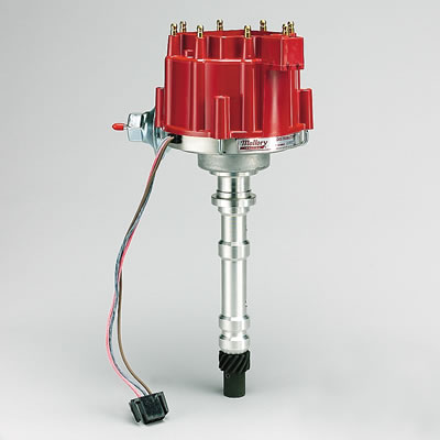

Old Aug 2, 2003 | 04:45 PM
mypurple92rs's Avatar
Posts: 210
From: southeast of rochester NY
Car: 86 iroc
Engine: 350 carbed
Transmission: t5
so something like this
