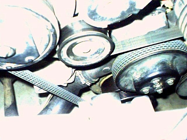

no worries. it won't affect anything besides emissions. if you don't need your car to pass emissions...pull it outta there. It's pretty easy to do. But you will probably need a new belt. I put an underdrive pulley on at the same time so i didn't need a new belt.
