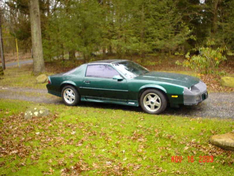

I have a 92 camaro RS 305 tbi. I have smoke coming out of my air cleaner. I went to change the pcv but when I put my thumb over the hose no vaccum. So I need help. What do I do now? Any thing will help
