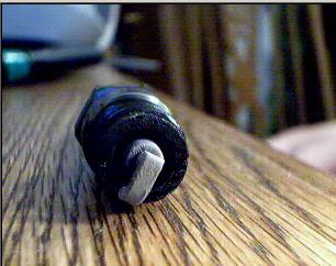

I am feeling some surging in my car in 2nd and 3rd gear at the track, and on the street... not really noticably in 4th gear because i am never at WOT in 4th. so i checked the temperature of my header primary tubes of each cylinder with a laser thermometer. cylinder 3 and 4 were both around 300-315 F* while the rest were about 400-425 F*.... so i pulled plug number 3 and this is what it looks like... i would describe the color as a light light brownish white.... and there was a lil bit of oil on the threads of the plug... here are 2 pictures.... any ideas?

pic #2
here it is

here is a pic of #1
all 8 really look the same.... a lil bit of oil around the threads... but nothing to be concerned about... i do not think.... there was slightly more oil on #3 than the rest of them though... the color on all 8 are about the same also

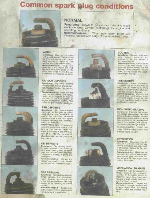

Looks like white hot ash, Id go one plug range cooler/ make sure your other Ign parts are up to specs. Are you running any additives in your gas???
I have noticed on both my 2nd and 3rd gen that they sometimes need good full tune up, even when its not needed.
2 times I spent week and tossing money at problems
when some 98 cents plugs or $15 wires, fixed everything, even though it wasn't anywhere near time for it.
Matt

OK Ill edit my post. It read as if you were mad, like I was dissing your car or setup/parts.
98 cents plugs are usually champion, wouldn't use em but in a lawnmower.
on my 2nd gen I spend $100's on new IGN parts but some cheap 98 cents plug fixed it up. It was no where time for new plugs, the old ones looked fine but as a last ditch effort, they fixed everything.
My 3rd gen I spent weeks chasing codes, replacing relays, checking pressure and flow. 3 stock coil and then some $15 autozone wires fixed everything. Wasn't even time for it but I was back on my original accell coil and all my driving and leaking coil problems went away.
For me , its seams our cars eat Ign parts like candy at times./ the Ign system is so picky, a tiny flaw mucks it up.
Your plugs look blistered white hot. Id run a 1 step colder plug in it for a week or so, maybe just use some cheap champion plugs just for the test. but only if the other parts are up to specs.
Then see what the color is. But I'm betting your other Ign parts are up to snuff and them $3 plugs are to hot. Or you could be lean. But I kind of assume its not.

well.... i know my car was lean for a while, then i got it dyno tuned and it is running art 13:1 a/f ratio now....
I think i might change the plugs, see what that does
