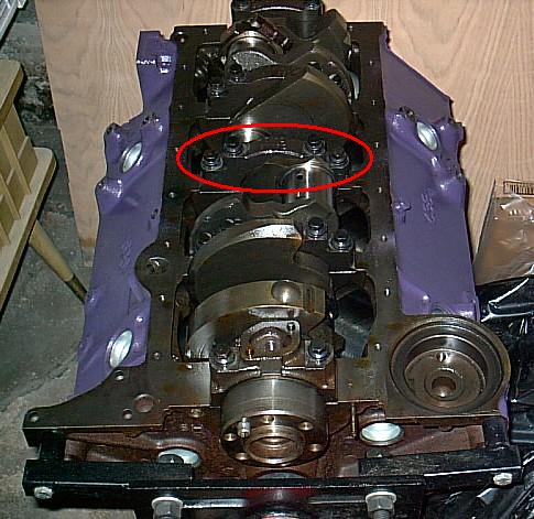

Just to help you actually realize what a 4 bolt and what a 2 bolt are.
Here's a 2 bolt.

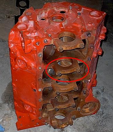

A 4 bolt.
