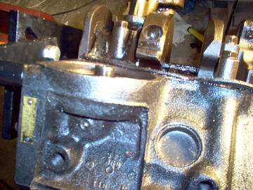

and another...i just hope it doesnt crack upwards towards the top of the engine...HEH

I would just smoothen it out to remove any stress riser.
Epoxy will only act like a bondo - you know for looks.
Ron

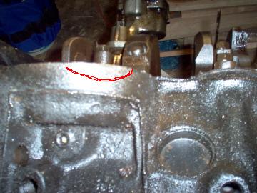

here i drew a line over the crack, its not a very thick crack...and it doesnt go all the way through...
and finding another 4 bolt 350 around here runs 300 for just the bare block.....id rather fix what i have ..ya know....IF its fixable...
like i said i *think* itll be ok as is......due to it being a non stress part of the engine
this crack does not go through to the wall behind it, but heat bay make it crack through....
well the ends od the cracks are basicy on the edge of the rim as you can see in the re done pic....i was just suggesting epoxy so the metal wouldnt fall off....i know it wouldnt actually fix the crack

ok i see it now. if that's all it is it doesn't look like it can go anywhere and doesn't hurt anything structurally. i think i'd grind it a bit and fill it with epoxy, jb weld, or devcon.
