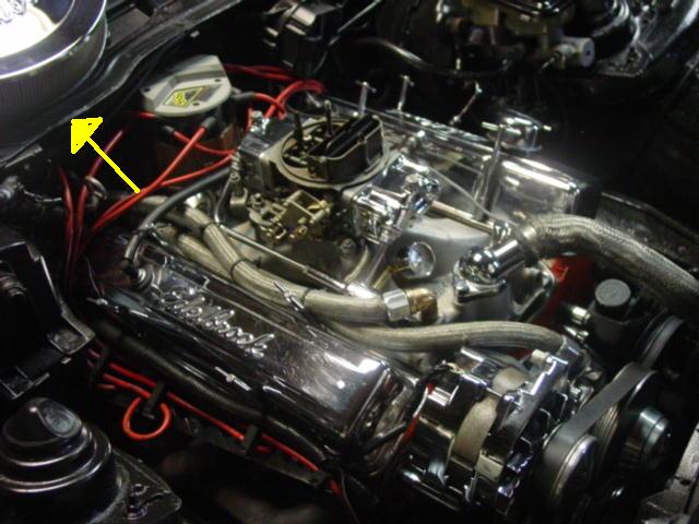

Here is what I run on my 86 Z28. I even have a victor jr intake. You can see the filter I linked you too in the top left corner of the pic.
