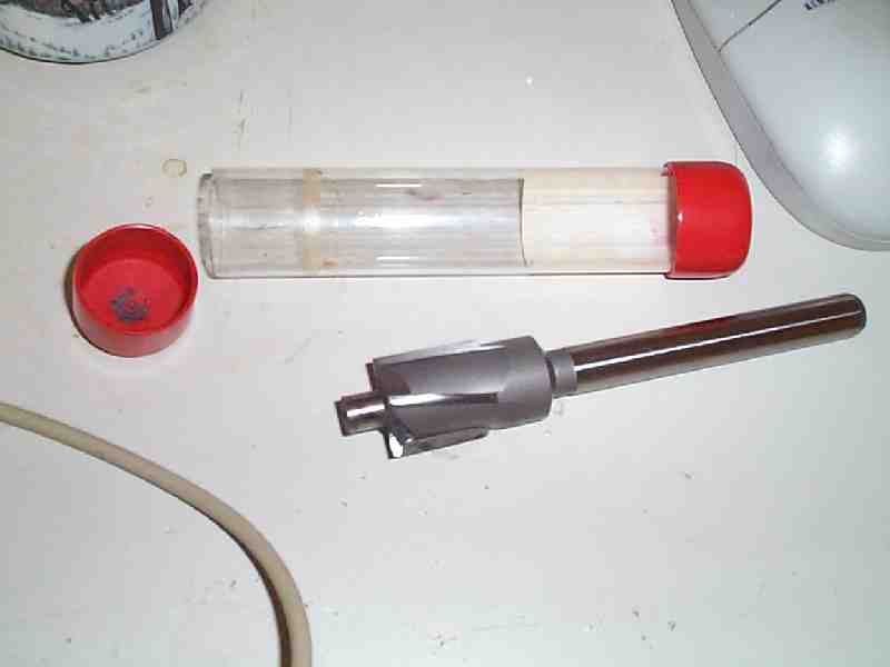

Machine down about 0.250" for typical (ARP, GMPP, Comp Cams) hex-collared studs (from the blueprinted location of the stud base) and add whatever the thickness of the guide plates might be if you plan to use them - usually about 0.400" total as ede stated.
You'll have to determine the blueprinted height of the studs before removing them, then indicate from the machined pads on the top side of the head perimeter to set your depth.
Obviously, a mill would be best, but with careful adjustment of alignment and depth control, your results can be just as accurate with a drill press. I've had very good success with a piloted counterbore in a drill press.
