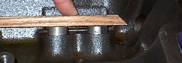

A while ago I took pictures of this to show someone that wasn't 100% convinced. A pic is worth 1,000 words..... or is it 180 words
This pic is with the cam and crank gear dots at 12 o'clock. Here's the #1 intake and exhaust lifters. As you can see they're both at the same height, which means the compression/power stroke.

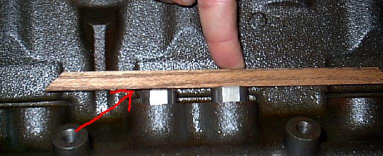

Here are the #6 lifters.
As you can see, they're not the same height. That means there's some overlap going on.
