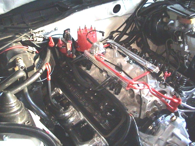

Heres how far along I am getting it all back together.......now the freakin bolt! DAMN!!!!
