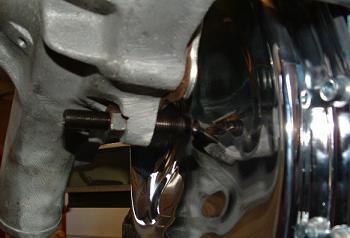

heh, personally i think drilling the block and all the mods for the inferior and only$50 cheaper "factory" style rollersetup is foolhardy...... anyhoo...
heres a nice bowtie alum timing cover i got... it was polished, but im not into the polished look so i beadblasted it.
should stop any flex at all... the thing is pretty beefy.

I tried to used a cast aluminum cover but when I bolted it on to check for clearance I broke it. The cam button broke the center. I just want to extend a warning to not do as I did. You may have to mill the little "cast in" center hump on the back side of the cover to achieve the proper clearance, or stack gaskets maybe. Comp or someone has a cover that has a locking allen screw in that area.
the button i have has a roller bearing that i can preload with shims... taking a few shims out should let me get it right... if not, i'll mill it down some...
thanks for the warning though.

$200 for a set of retro roller hydraulic lifters? That's funny? Please list a supplier that sells them new for that price. I would bet they are closer to the $400 range.
Now back to the topic
The conversion is easy and pretty straight forward.
The V6 lifters are internally the same as the V8 lifters. The OD of the lifters is the same. The rollers are the same Diameter. The only difference is that the V6 lifter housing is .4" shorter.
so those are 4.3 V6 lifters? or 2.8? 3.1? 3.4?
The following are said to be the right lifters.
S-Series - 2.2L 1994 - 2003
Beretta, Corsica - 2.2L 1994 - 1996
All Models, Eng/Code J - 3.1L 2000 - 2001
Impala, Monte Carlo - 3.4L 2000 - 2003
I bet those shorter lifters due to thier smaller packaging and lack of a captive link bar are much lighter than an expensive retrofit hydraulic lifter made for non-roller motors. If this is the case then this would be worth doing on just about any hyd roller motor. Any lighter is better even the tiniest amount, especially for the wicked valve float inherent to hydraulic lifters when reving and especially bad in aftermarket hydraulic lifters.

Has anyone thought of using a Custom Hyd Roller on a small base circle to allow the use of the V8 lifters?
If they really are .4" taller than thats a huge problem, I dont think they grind cams on .700 base circles, but if that was a type and they are .040 or something smaller then its a possibility?
Anyone actually measured the height of a V6 lifter VS V8 roller?
Yes, (see my above posts and following picture)
Old May 12, 2004 | 04:10 PM
  #44
B4Ctom1's Avatar
Veteran: Air Force
Posts: 4,991
From: Cheyenne, Wyoming
Car: 1992 B4C 1LE
I am convinced...
