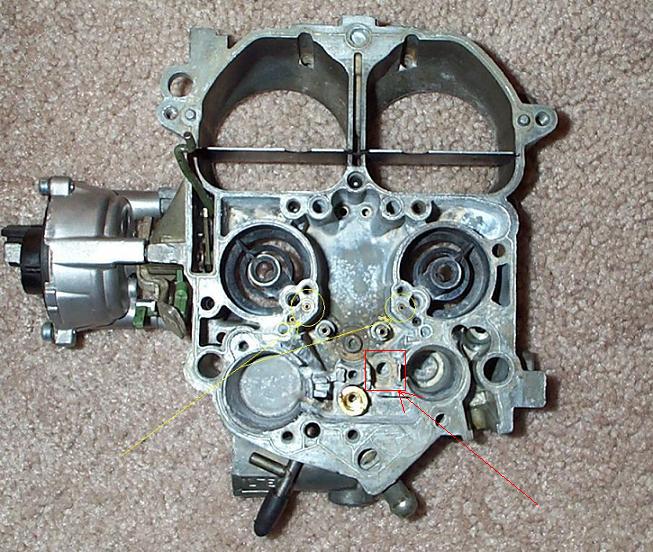

Ok, no one has replied. Well, I took the carb apart, and lo and behold, two of the holes (not sure what they are for exactly, I'm hoping someone can clarify that for me?) are plugged up. You cannot tell in the pic, but there is a bunch of sand-like stuff in the holes, and cannot be blown through.
Can someone answer my previous question, and let me know if this would affect the car running. When I came home this weekend, it ran, but not very well, and it kept gettin worse, only running for even shorter spurts of time, less and less each time I tried to run it. I'm thinking this sand just kept clogging the holes more each time I ran it.

Forgot pic.

After further disassembling the carb, I found out that I did not install the spring where the check ball is (in the bottom of the float bowl). I'm not sure what that is for either, but my guess again is that this would affect how it ran. Anyone?

See atatched pic, red.

More of teh bad gas issue. The bad gas will stick up any thing in a carb. Especially if teh carb sat on the car all winter without being run. Then once you add the new gas it loosens up more and more of teh varnish clogging air bleeds , idle jets etc..... Once you rebuild the carb, I would install an inline fuel filter on both the tank side and carb side of teh pump. You should be looking pretty after that.....

No one knows what those holes are for...I cant hardly believe that.
I know theres guys, or possibly gals, on here that know Qjets enough to know what those holes/spring and checkball are for...
Please? I'd really like to know.

The holes that you have circled are part of the main metering system. IIRC they control transition (part throttle) metering. The other ones ar ethe idle air bleeds. I may have them backwards. In either case, having them plugged will create massive driveability issues; stumbling, lean or rich running, etc.
The check ball is on the discharge side of the accelerator pump, such that when you open the throttle, the fule being pumped lifts it off of the seat. Without it, the pump discharge nozzle can actually behave like a little discharge nozzle at sustained high RPMs, and feed extra fuel by siphoning it through the accel pump circuit.
Make sure there's a fuel filter in the inlet nut. Go get a new one, and remove the rubber valve thing from out of it before installing it.

Sorry this thread is getting old, just have one quick question. I searched but didnt find anything related. Concerning the check ball, can anyone tell me if there should be a spring between the screw and the ball? The diagram in the rebuild kits do not show anything, but I seem to have a spring that goes there? Anyone know?
