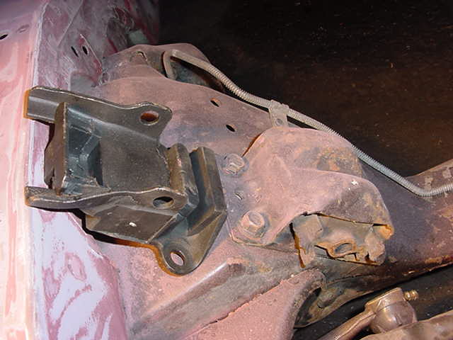

Right,well i got them off thanks to a disc cutter.
However check out these pics as the one my GM dealer has supplied are nothing like what came off.What do you think??

That part is the motor side of the system, for cars from about 72 back. Those earlier cars used a plain metal bracket that mounted on the stand, and that piece that you have on the motor. Kind of backwards from what these cars have.
Take it back and get the right one, is about all you can do.

Engine: ZZ4,Holley Stealth Ram,Commander 950
thats what i thought .Thanks guys
