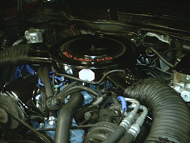

I'm happy and sad at the same time. My L69 runs great, but I'm pulling it in favor of a 408 I had built professionally. I just got word that the engine is done, and ready for the dyno.
So - the HO will see some time on a stand until I figure out what to do with it. It was a full rebuild by me two years ago!! I put over 900 bucks into the machine work alone! But I did all the cleaning, disassembly, reassembly etc....which saved $$$, but I still have 1200 into it. I have done a few before.
I'd say less than 10,000 miles since it was done. So anyways, what's the best course of action here?? Keep the oil in it and prime it every once in a while with a drill and oil pump drive tool?
Or drain everything, fog the cylinders with fogging oil and put a bag on it?? I don't want it to go to waste, that's all.
