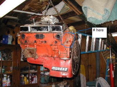

Or run the casting # on the block if its a sbc...look here..see pic of dead 327.....
run the 3 at www.mortec.com
