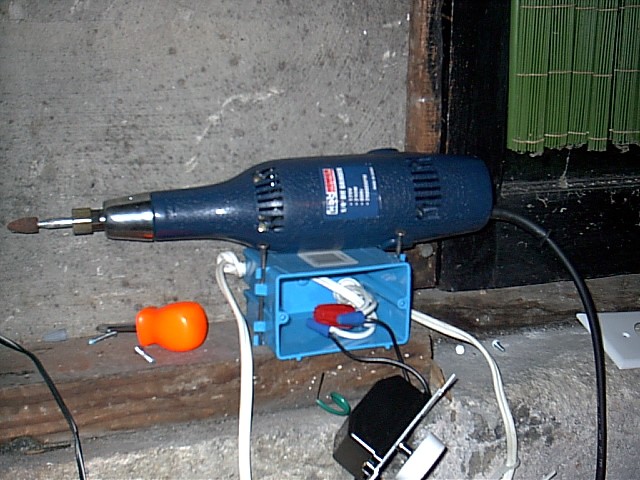

Here's how you can control the speed of an electric die grinder that doesn't have a speed setting.

Nifty...i've heard of that, and it was even recommended in my little "porting guide" that came with my standard abrasives kit. Good idea though. I personally like an air grinder as it's smaller and easier to control for me. I do kinda have little hands tho.
