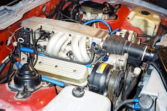

I took off my tubes and left the pump cause i got serpentine no probs yet! Much easier geting to the spark plugs now!
