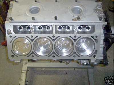

A picture is worth 1000 words.
Let's start with the head bolt pattern on the block. Obviously, you can't put heads on a block if the bolt holes don't line up.
Whaddya think?

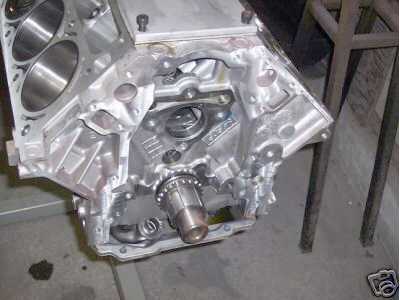

Here's a shot of the area under the timing cover. Note the oil pump parts on the crank and the oil pump pickup tube.
I could be wrong but I don't think a SBC oil pump will fit there.

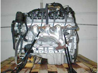

And last but not least, here's a shot of an exhaust manifold. Somehow I don't think any exhaust parts will be interchanging either.
So, all I can figure is, this guy has never seen a LS1 in his life except through the fenders and closed hood, and is merely shooting off his mouth, to the amusement of all his co-workers.
All these pics BTW are lifted off of eBay.
