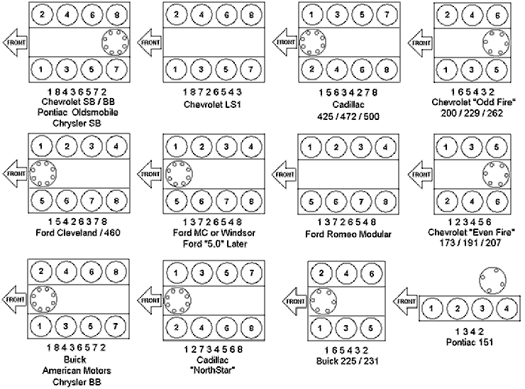

I heard that the firing order in the haynes maual was incorrect. I hooked up the wires according to the book and I think it is indeed wrong. Curious if anyone knew the correct firing order.

1-8-4-3-6-5-7-2

here is some more help
