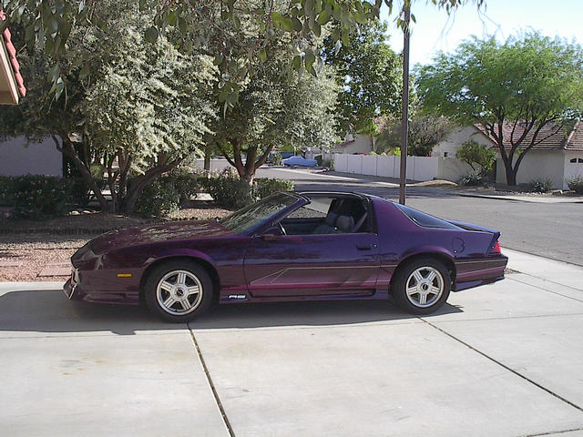

By the way Andrew, I just read your sig, nice car. Does it look anything like this:

yeah, it looks exactly like that except with no decals on the side.

Yeah. I didn't like them at first and had decided to take them off when I bought the car three years ago. But I like them now. kinda breaks it up a bit. Also makes it unique. I'll leave them as long as they look good and don't start to crack and peel.
