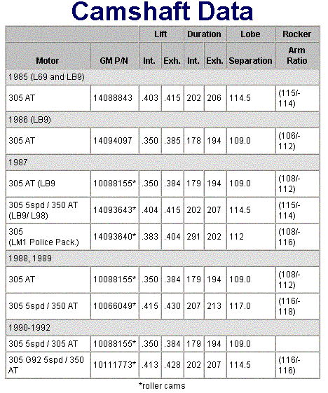

While I have to say that's a good deal, it's not gonna do a lot of good.
As freeman pointed out, it's not very aggressive. Look at the specs on your stock cam, then look at that cam at Summit.
About the only advantage with the Summit cam is the lift, and a little more duration on the exhaust side. Not worth it IMO.
BTW, ignore the "40 extra horsepower" comment. 35 HP of that probably came from the reprogrammed chip, new valve springs, and a good tune up.
EDIT: My bad. I was looking at the '85 cam. If that chart is correct, and your stock cam is that "tame", then it would help A LOT to use that Summit cam.

Freeman: Well, the thing is that my '86 got a horrible camshaft compared to the '85...
“The TPI 305 was the lucky recipient of the LG4 camshaft, and the result was a drop of 25 horses and almost a half second longer run to 60mph.” -Iroczone.com
So while it isnt much larger than yours, it would be a large improvement over my stock cam (I was hoping).
