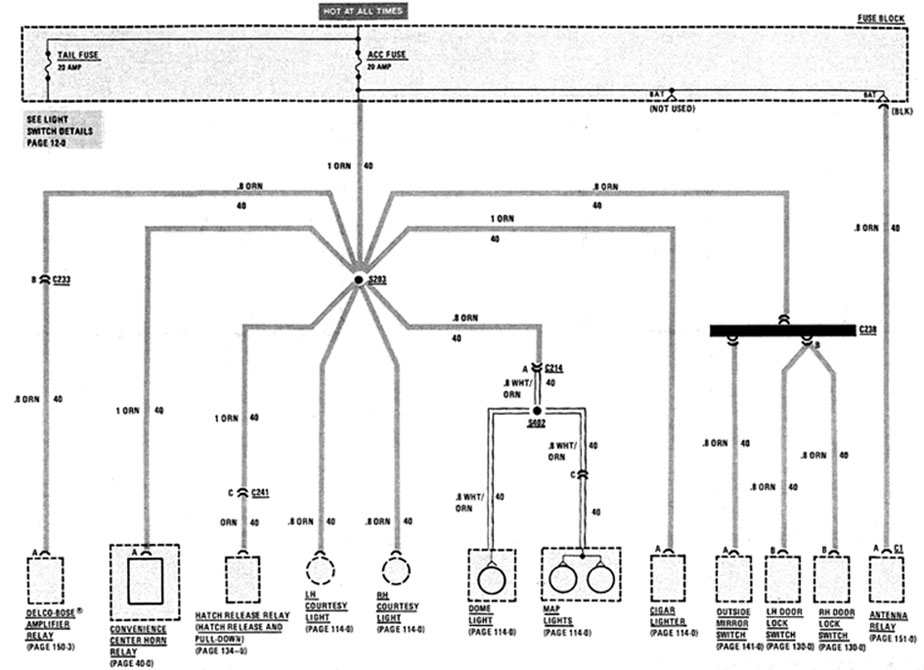

Ever since i got my car back from a friend who was supposed to do my TPI swap and bailed out on me and left me with a mess to figure out. I noticed i have no power to my dome light, power locks, deck lid and power mirrors. But the radio, power windows and rear trunk light work fine. All my fuses check out ok. I am thinking maybe he unplugged something under the dash and i can't seem to locate it. Any idea on what to look for ???

Maybe this will help.

Thanks trickster...i see most of the things seem to link u p to the ACC FUSE...........Funny thing is, there is no fuse in my ACC slot....it calls for a 20 amp ...i thought that might be my problem but i tried to stick in 20 amp fuses in twice and it blew both of them instantly.....anyone know what that could be about, i didn't really mess with any of the wiring under the dash?.

Disconnect the battery and drop the fuse panel down and check the wiring there. The fuse panel is usually held in place with a plastic clip and swings down on a hinge. Your buddy may have tried to jumper something into that slot since it is a source of constant power to some systems
