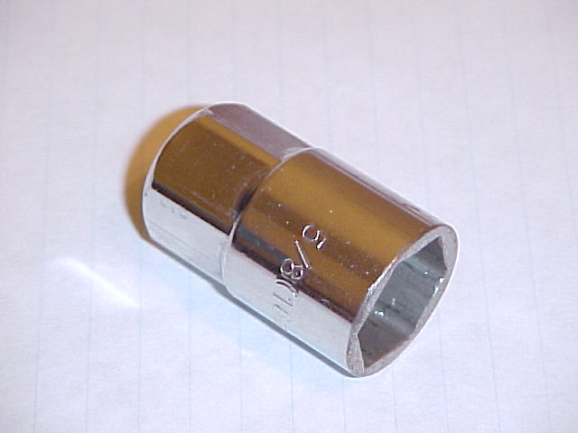

Yes. You can use a deep well 5/8" socket. You may also want to get a modified socket that you can use with a wrench. I can change my plugs in 10 minutes with this socket. Just apply slow even pressure and they will break loose.
