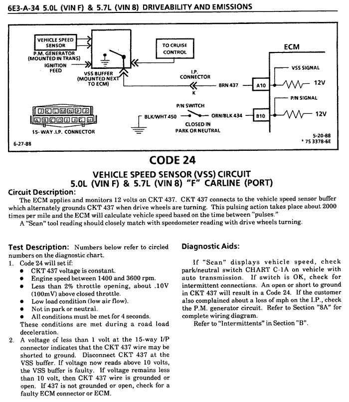

HHHMMMM,
How about a broken or shorted wire?
Just a thought!!!!!!!!!!!!

The wiring (at least in the detail your picture speaks of) didn't occur to me at the time, but that's good info! I'll mention it to Eric on Monday when he checks the car (again). I'll give 'em another hour to work on it so he can swap out speedo cables and check the wiring in that diagram. Thanks for the heads-up.
