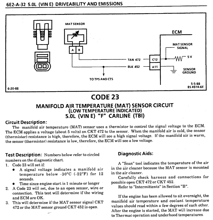

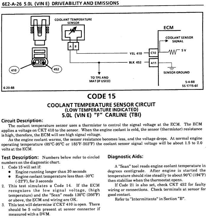

Code 15= Coolant Temp Sensor Circuit (Low Temperature Indicated)
Code 23= Manifold Air Temperature (MAT) Sensor Circuit (Low Temperature Indicated)
Code 32= Exhaust Gas Recirculation Circuit
Notice that pin "A" on the CTS (15) & MAT (23) are both grounds and are linked together along with the TPS by a wire splice.

code 23

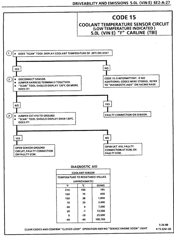

Here is the secod page of these troubleshooting charts.
