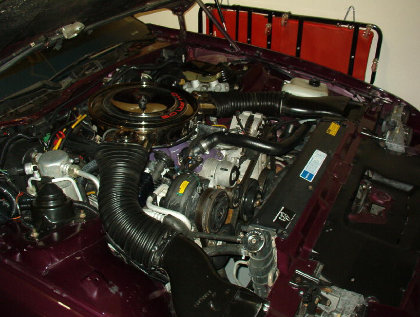

Oh I don't know. Black chrome dual snorkels look pretty good.

Engine: 305-4v
Oh man, that is beautiful!!!
Tell me how you did it and how much it cost, please!!!!

The black chrome was $260. Not very many shops will do it. I'm not sure how it is done but there are some special processes that not all shop will take on. You may have to check around a bit to find a shop that does black chrome.
Just to give you an idea of the add cost, my previous dual snorkel I have done in regualr chrome and it was $85.
Ofcourse those prices are just for the plating and does not include the dual snorkel. Which are running anywhere from $100 - $150 or more for a good one. And that will probably not include the duct work.
I think I have some more pics. I'll post if I can find.
