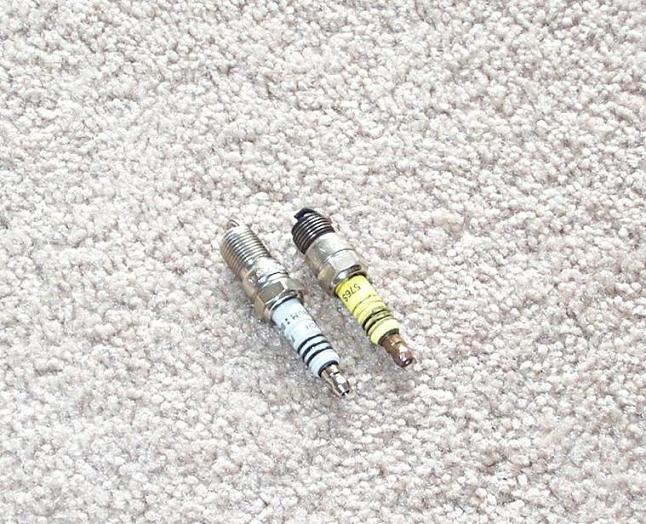

On second thought, heres a pic, so if anyone can identify these plugs for me, thanks. It may help out?

87Formula4bbl
First of all the 2 plugs in the pic dont have the same reach, which could be part of the problem. Which plug were you having the problems with?
The platinum appears to be the proper reach for a Vortec head while the other plug is for a iron L98 head.
For your application I would recomend that you dump that Bosch crap and run a NGK TR55. The TR55 is the proper reach and proper heat range for Vortec heads and a mild motor.

Thanks for all the posts guys. About the spark plug picture, thats from when I found out that I actually needed a longer-reach plug for the Vortecs, and when I bought a new set to fit I took a quick picture to show the difference in length between my old ones and new ones. I'm running it now with the Bosch's (left side). Looks like I'll just have to step up the octane level, which I guess woudlnt be a bad thing because anything more than about 6* base, it will ping under heavy load sometimes. Maybe I'm missing out on a bit of power here and can run more base with better gas (I still have the LG4 computer-based equipment too). I guess I'll try it out and see how she runs (I'm almost sure this will fix my problem, I just wanted it to be my last resort with gas prices as they currently are). Once again, thanks for the replies, and I'll let ya know if this helped cause I'll be filling up today, I'm empty.
