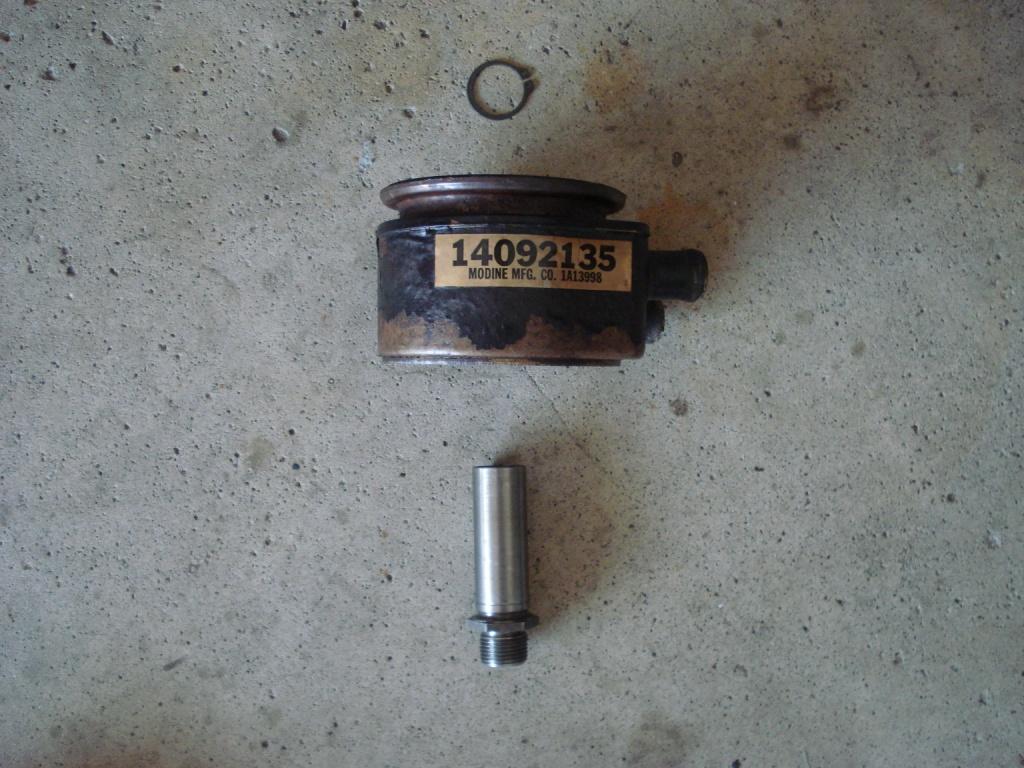

hey guys, i recently pulled the motor in my Z b/c of what turns out to be a broken flexplate (got torque? LOL)
anyway, i decided to strip the motor, clean it all up, paint the block, etc...so... upon removing the big center "bolt" that holds the actual cooler to the block, i found a snap ring/c-clip type deal laying right on top of the cooler (between the block and cooler)
Now, by looking at the bolt/shaft that holds the assembly on, i see a grooved area that the c-clip fits perfectly in as far as thickness goes but it seems that the diameter of the ring may be too small b/c I have to really stretch it to get it on there. Also, this would mean the ring belongs on the FILTER side which is impossible b/c i fouind it on the block side. I dont think it belongs in this "groove" b/c if i were to bolt it all back up together, the cooler assembly would be LOOSE if i left the c-clicp in this groove.
I dont see hpw it could have passed through any oil holes from the block...IT WAS JUSTY LAYING ON TOP of the dang cooler\
WHAT/WHERE does it go???????

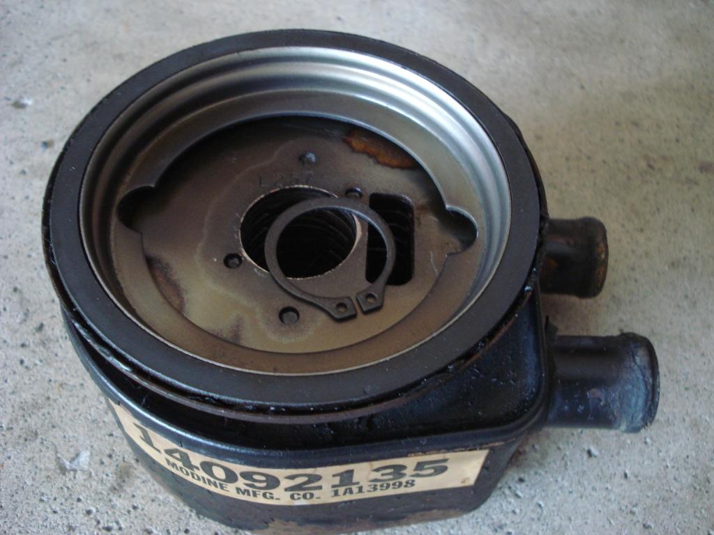

I found 2 very old threads with no answers, so I'm giving this a try with pics. My question is EXACTLY the same as post #1.
Pics show the order the parts were when I disassembled it.
An answer would be much appreciated.

I rebuilt my engine last summer and when I pulled my oil cooler adapter off, the snap ring was installed around the shaft about an 1/8 of an inch or so from making contact with the cooler body if my memory serves me correctly. I didn't remove it and it seems to be there as a method to retain the shaft, but for the life of me I don't see how it would work. I have an assembly manual for my car and will look through it and if I can find any detail I will post it here. Not much help I know, but it's all I got.

I need to know where the snap ring goes on reassembly.
Although I do not see what function it serves, I know The General would not spend a fraction of a cent on a snap ring unnecessarily.

The snap ring goes exactly wher you pictured it. The threaded sleeve goes through the heat exchanger an d the snap ring goes into over it. It does come off very easily and it only there to ease assembly. Upon disassembly it's very common that the sleeve threads out but the heat exchanger sticks on it's gasket and hangs up there, pushing the clip off. In fact, it works fine without it, just a little more annoying to install it under the car that way

Great answers guys, thanks.
Snap ring is going into a spare parts drawer.
