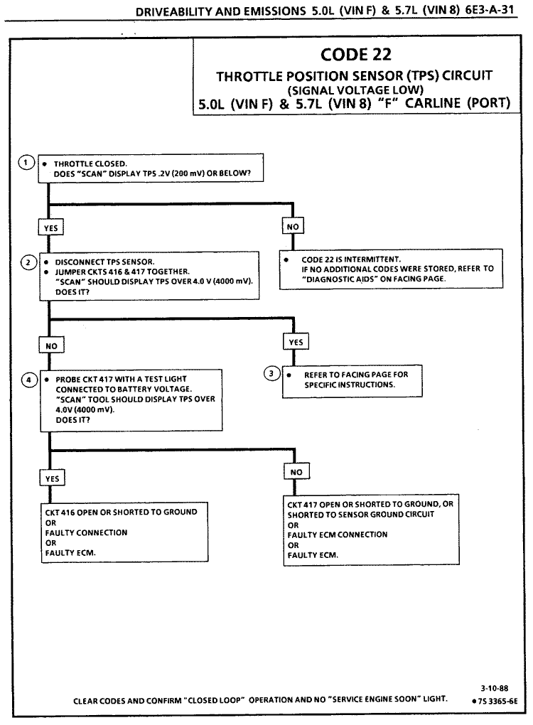

Here is a little something to help with your problem.

page 2

Thanks for the help, I Changed the TPS and I hope that fixed the problem, should know tomorrow if I make it school with out breaking down again.
Thanks again
