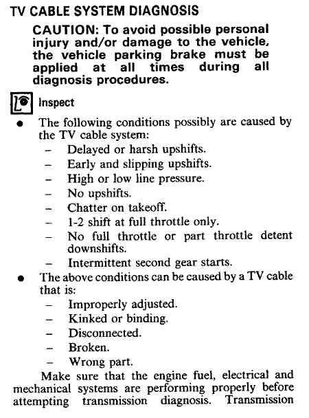

Start with this and try them, when you notice a difference in your problem. It will give you and idea of where the problem is and you can correct it.

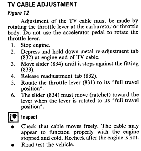

page 2

OK, I re-adjusted the TV cable and nothing improved. Still the same symptoms. Regardless, thanks for the help Trickster. If I do disconnect the convertor lock-up connector on the tranny, and the high idle, and hard down-shift goes away, what would I need to replace/repair?
