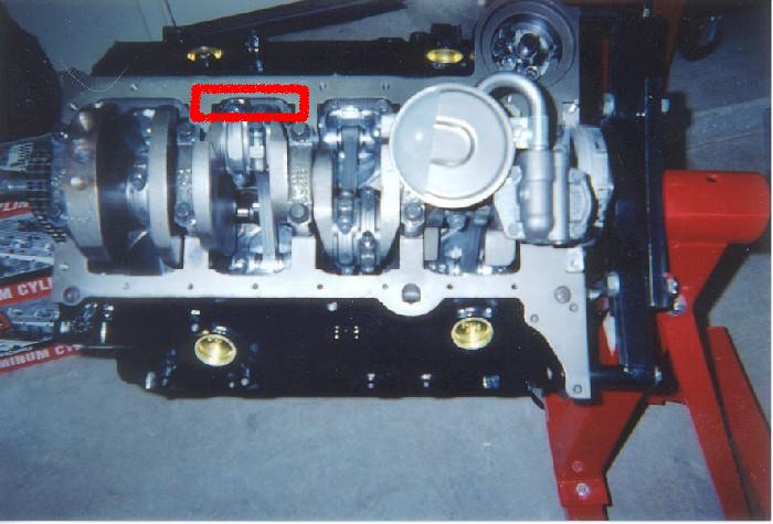

Tossing in a stoker crank without having the block machied to hold it and you will never turn the motor over.
As I said origianlly, my statement had excatly nothing to do though with crank mains however, when you opted to corect the statement.
Cant stuff a 383 crank in without doing this first.

You always have to clearance a 350 block for a 3.75" stroke crank. What the mains are ground to doesn't have anything to do with that.
Exactly right.
Without machining the block the motor will never turn over, for obvious reasons.

LOL if you dont machine that block your gonna have a big problem real quick ...LMAO
